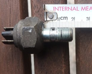

I need to find a replacement for a rusty rear brake light switch on my Jota. What is the correct size? Is the thread m10x1 or m10x1.25? And the length? Any links to point to a suitable product?
Thanks, but I already found one locally. Not the same as original, but should do just fine.

The question regarding the length was answered by a mate of mine. It seems to be 19mm.

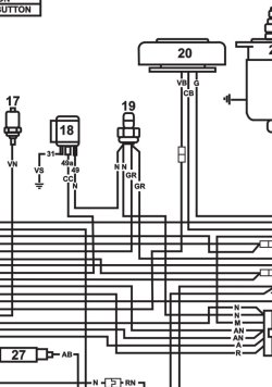

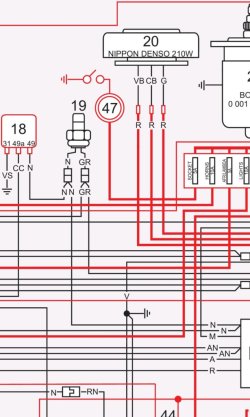

And one thing that puzzled me earlier is how do the front and rear switch work together. Here is the answer; the original wiring diagram is not accurate, there are connector on rear switch wiring, and now the operation is obvious.
The wirings are basically the same, but for me, seeing the connectors helps to understand how it works.

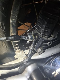

That was an easy fix. Even though the bolt was few millimetres longer than the original, there was no need for any work. The switch came with a couple of thicker usit washers, and I only needed to bolt it on. The spanner size is 14mm.
