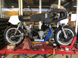

Its a very difficult thing deciding exactly what is right for a bike I know little about other than theories.
I am aiming for a very serious amount of power, and power to weight.
Aiming to have it race ready and with rider at 200kg all in.
That is a very light bike! running a 130 rear and 90 front so not a massive amount of tyre but with a light bike the theory is possible but I think I may / will struggle if the power I want is achieved.
Drums all round, not worried about grabbing as we work all day with drums and generally grabbing can be dealt with by setting up well.
Due to the light weight of the bike and the fact that whatever I do the rider will be at least 1/3 of the weight of the all up weight, this means the CofG will be relatively high,
Therefore maybe a high probability of large weight transfer etc.
At the moment I calculate a 55/45 weight bias forward but again only theory.
Therefore I must account for allowing the rider the choice of using the rear brake as much as he/she would like, so think it would be silly to fit a smaller rear drum to save weight but sacrifice possible braking.
Will weigh the front and rear wheel assemblies this weekend and see the difference in drum weight as an indication of the weight gain I would see by using the matching yamaha rear drum over the Laverda.

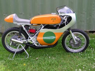

Grimeca rear off a 650 Benelli on this. Guy I built it for gave several options, this was the lightest.
