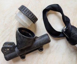

Rear m/c reservoir removal - how?
Hi Rob, Inside isn't there a couple of allen screws to undo first, my memory!
Remove screws if there and then the plastic bowel will unscrew anti-clockwise.
Andy
PS I've always used expandable grips to grip plastic to undo.
Never tried it on this item Rob but I have a rubber strap wrench that has proved very handy in similar scenarios if it’s stuck a bit after Andy’s guidance.
David 🤔
drop it in boiling water, and get it hot, then (using gloves) FIT THE CAP and unscrew using a strap wrench, if it looks like crushing you stop, but you knew the last bit anyway.
