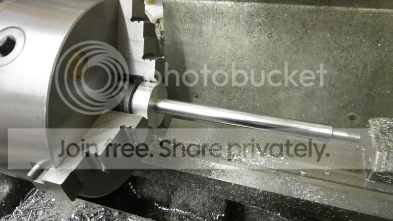

That's exactly what I did - bought a lathe and milling machine, having never worked in Engineering or had training or experience, and taught myself as I went along.
This project has all been done by me on my old Brit machines;
Cool thing that.
  Keith
In my opinion the secret of any good machine be it lathe or mill  is weight and that's where the old Brit stuff scores. Before i started messing about with spare parts i spent 36 years as a tool maker in the same engineering shop. We worked on prototype medical research equip but the workshops always came alive at lunch time as the bike parts came out and what was called "home office" jobs were worked on :). Although i left nearly 3 years ago they still let me back in to the machine shop to do my projects  :D
