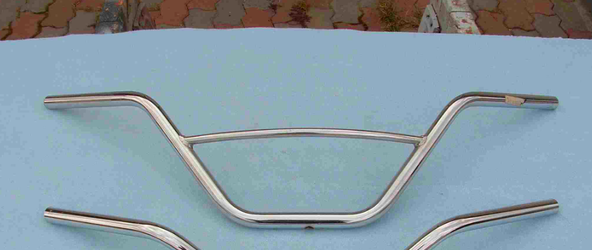

As you're probably aware, it's nigh on impossible to get hold of the 750 GT high 'touring' handlebars with the curved brace. Wolfgang doesn't have them to hand, Andy is out of stock, and they rarely if ever show up on eBay, etc.
So, I made an enquiry with Armour Motor Products here in the UK who said they could replicate them if I could provide measurements. I don't have a pair to measure but wondered if one of you might - and could help me get this mini-project off the ground?
At least this way they would become available for anyone else who might need a pair down the line.
Pic of the bars for clarity:
Is this the version you're looking for dimensions from?
I have a couple of bikes in the boneyard that have this I think as original equipment plus this loose set: about 32 inches width and about 8 inches rise, holes for wiring at lower centre and for starter switch mounting. Cross bar is curved in horizontal plane when mounted.

Thanks for pictures. To be honest, I don’t know what the originals look like. One is GTL, and the bars were changed out for lower ones some 40 odd years ago and I no longer have the originals. I’m not fussed about being exactly OE, I just want a higher set of bars to match my sedate riding these days. I’m in UK, so would prefer UK supply if possible.
The handlebar arancia posted is the correct GT item, with holes for wiring and starter button.
