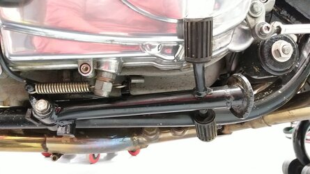

A spring puller takes the pain out of it......a left over from the MX days.......

Spring Pull isn't easy to bend around the sidestand bracket... with the engine in place, you only have around 2-3cm between engine and sidestand. The zip tie can be looped around the sidestand and then you just pull the spring around with it and in position. If the spring has very high tension, the spring puller might be handy though for the last centimers. Just my 2 cents...

I was thinking along the same lines as Steve. Chuck the horrible clock spring away and fit a coil spring. Obviously the coil spring mounting pins or hooks would have to be made and welded on to the stand and frame. A little thought would need to be applied to the spring hook locations so the spring will go over-centre when the stand is deployed, and stays down.

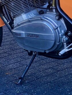

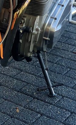

Made it

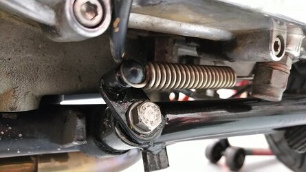

Can't claim credit, Dad did this one, way back when the bike was only a year or two old. The spring bit is a very easy mod and works perfectly. The slightly extended tang and non-retracting nature makes it simple to deploy while seated, even for the short-arses like myself.
Some adjustment via adding weld or grinding away allows the stand to stop the appropriate amount forward of the pivot, and then some adjustment to the angle of the foot makes it sit nicely on flat ground. Length may also need to be tweaked to get the right lean angle. Make any adjustments to length down at the foot end, there is little bending on the stand down there so the weld is not stressed. Dad originally added a much larger foot area also, but I have brought that back to something approximating original.
I'll add the disclaimer that if you do this mod you should add an ignition cutout switch.
EDIT: Now I look at the photos I remember this is a newish stand that I fitted only a year or two ago. My original was very flogged out in the pivot bore and it was easier to get a new stand from WH and redo the mods copying what Dad did. You can see I've adjusted the length at the foot end, but not hard mods for anyone to make even if you have to get a local workshop to weld it.
