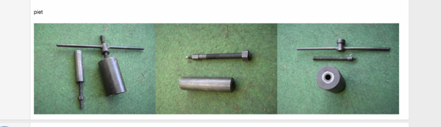

I'd like to remove the cam follower spindles and have read info on heating up the cylinder w/ a torch or oven. Should the spindles then just drop out by twisting the slot w/ a large screw driver? In case this won't work, can anyone advise how to fashion an extractor like the factory tool that uses a long 6mm bolt?

You don't need much heat at all to make it very easy to remove the spindles, Ted. You can fashion a simple puller using a long M6 bolt and a spacer. Screw the bolt or all-thread into the threaded spindle hole with a socket or similar spacer and washer and nut over them. Apply a little heat locally with a paint stirpper heat gun and wind the nut down - you'll find the spindle moves very easily and can be pulled out once it's come out about 10mm.
No need, Ted - this forum is all about helping fellow owners learn about their bikes. Great prints though!
M6 all-thread is cheap and easy to find. The spindles aren't that tight - a very light interference fit; nothing remotely like a press fit. i confess to having removed them cold at times, without stress or damage.
Fitting is even easier - warm head, a soft punch and they go in with ease (cams on compression stroke for each side of course) - you need to align the cutout in each spindle so it mates with the stud holes (looking down where the studs will fit when refitting the head). The big slot allows you to rotate the spindle, if the head is warmed sufficiently.
