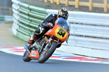

What a sound!! perfect idle! which exhaust do you have? any engine modifications? is a 500s or standard?
Miguel
Hi, my engine has every possible modification, Carrillo rods, Ross pistons, S1 cams, Atlas valves in modified valve seats, barrel base machined to bump compression, I can adjust the valve timing using slotted cam wheels the only thing I have never found is a close ratio gearbox but at my skill level, I doubt the importance of that. The exhaust is a full factory Barcelona system (thanks Phil)
I have since modified it again to try and appease the noise police at race meetings and track days, it was regularly hitting 102dB at around 5500rpm but it varies a lot depending where you do the test. If you test on a grass surface like we do at Cadwell Park i measures around 98 < 100dB at Anglesey on concrete with a queue of 30 bikes behind you all revving their engines, it will hit 104dB
I had another system manufactured using those but ugly cans that all classic bikes are forced to use, the main pipes are much bigger than the Barca system but after on meeting, the muntings had broken on one side, like I say, they really know how to vibrate these little twins
Since that video I fitted Keihin Roundslide CR carbs on modified inlet stubs. This has been a pain in the arse to be honest, it will not tick over like it did with the Dels fitted and teh reason I went to Ignitech was to try and dial out poor pick up from small throttle openings, once it gets onto half open or full throttle it is seriously quick for a little bike
I also have fully adjustable (compression / rebound) suspension and custom springs set up by a proper suspension firm, Davies rear shocks, fork brace (thanks Red) modified yokes and box section swing arm
It's a shame I am not as quick as the bike has potential to be but there is always a new season and more to learn

beautiful bike, beautiful sound
