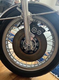

Have mounted BMW Brembo 4-pots, and based on this diagram, was thinking that I ought to flip the legs. Hopefully, I'll get the chance to wear some pads out!
