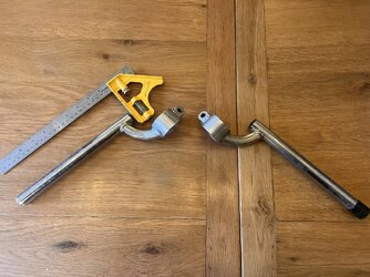

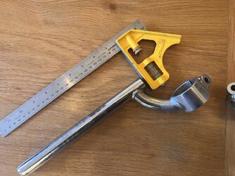

I know these are pretty rare so Alan Cudlipp has kindly lent me his set and I plan to get at least one set made up for my Corsa. I am happy to get four extra sets made if anyone is after a pair? I am off to a tube manipulater today to get a price for fabrication if you are interested in a pair let me know and i will get back to you with a price once I know. I will get mine powdercoated black and would be happy to get the others done likewise or leave bare so you can get your set chromed as you wish. No issue shipping anywhere at your cost. Without packaging the pair weigh 1kg.

Just did they do look excellent I see I can get them in the UK and ' Tarozzi adjustable clipons, high' @ 38mm might do the job? I have an Exec pad that I want to use on my Corsa has anyone got experience of these clipons or can point me in the right direction as an alternative to getting some sets made up of the originals?
