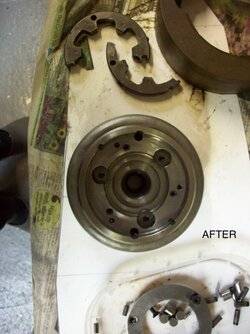

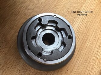

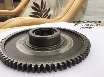

Thank you for all your replies guys. Sorry I should have said my location is Wales UK. To Paul Marx it may be contributory I don't know. The surface is slightly worn and what appears to be some flat spots using a mic. To redax5, I’ve tried Wolfgang but he was reluctant to supply as duty and postage would be more than the cost of product and delivery too long with no guarantees. He suggested Europe. Tried Laverda Paradies in Germany but closed. Tried Laverda Scozia Scotland - no stock, tried Webmoto UK - no stock. Last set from Motalia U.K., but minced plungers after one starting attempt. Had the unit refurbed and re assembled by well known and respected Laverda specialist here in U.K. but first attempt to start after re installation (long time turning but wouldn't fire, maybe carb problem) and it started clunking and the screeching again. Stripped it down, surface scored and damaged again, and cover ring buckled and damaged. 3 springs and 4 plungers now in the sump. I think you've all discouraged me from hard chroming , so another set of new parts and another rebuild looks best, if I can get the bits.

Cleaning up the housing per your photo may have allowed the rollers to be kicked at an angle which would also explain the buckled cover. Light indentation on the inner housing by the rollers is normal and only the worst ridges need dressing. As you have found tolerances are critical and sadly that means new parts. The previously split ramp ring (for lack of a better term!) may have stretched its housing.
