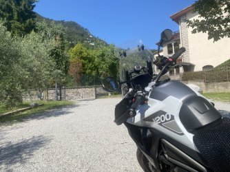

I also fitted an Alieexpress one - for £15 it was worth a try - survived for 3000 miles but not sure it would work on the RGS - the Triumph screen also has a slot in it IMG_1724.jpeg
The issue with the 2 arm ones is you need to make sure your original screen is wide enough to fit, my slightly taller Atlas screen is just wide enough with the mounts turned inwards a touch. Mine is multi-adjustable and strong enough to cope with Autobarn speeds, the cheaper ones are a lot less strong.
