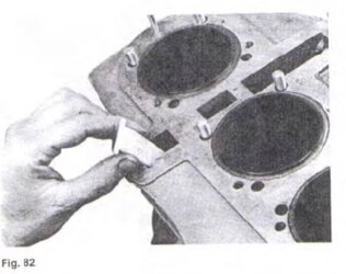

in what way is the front cam chain guide installed?
any help will be greatly appreciated
Thanks in advance
The nylon anti chatter blade has 4 locating pins cast into it - these locate in recesses machined into the crankcase and barrels. The workshop manual seems to skip over its replacement, but the blade needs to be slotted into position as the barrels are replaced. Care is needed to correctly position the blade to engage properly in the recesses - not unusual for the pins to be broken. The bottom pin locations are hidden as barrels are lowered. Factory workshop manual shows the top arrangement...
thank you Rob,
looks like its inserted from the top and twisted in place?
or do the barrels need to be off?
Jack W
Yes, they do. There are two similar tabs at the bottom.
If there aren't, you need a new one.
thanks all, found the problem, after I pulled the barrels found the base gasket facing front to back
and so hiding the bottom slots ! cursed myself for a while!!
