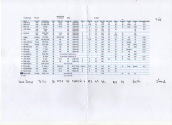

that is an old spreadsheet, for your engine if you feel 127.5 is too large, go down to the 125 mains that I supplied in the kit and try them but do not go lower without doing a dyno session to check fueling
