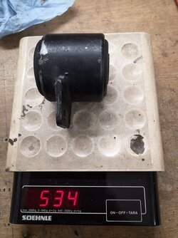

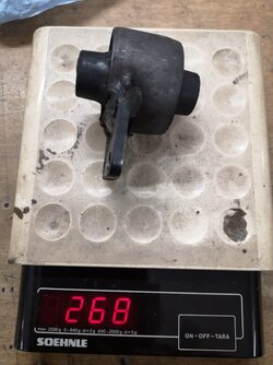

Are you using these without problems or extra vibrations?These are the engine mounts from Michael Stöcker sport-connection.de
You can safe 1.6 kg
