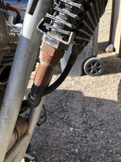

The black rubber hoses from the engine to the oil cooler are over 30 years old and due for replacement. Does anyone know what size the fittings are? I would like to verify that my local supplier has the correct parts before I take things apart and I do not have a metric thread gauge.

Are these the rebuildable type?
No, these are crimped and cannot be rebuilt, sorry.
Must be a very late RGS. This hose type, along with the cooler, was generally used on the 1000SFC, or have been replaced at some point.
In my experience, the rubber rarely perishes. If there are no signs of internal dissolving, the entire hose assembly can be re-plated as-is, as long as there are no aluminium alloy components involved.

this is what is known as the "big nut" oil cooler, very often the male thread will tear off with the nut when you dismantle it, this can be repaired, by welding half of a hose adapter to the cooler, not hard, the hoses can be made up by good hose people, the cranked ends are a bit difficult to find (engine end) but do able, and stainless crankcase adapters can also be obtained, probably from Ralph at Motalia (UK), he might even have the hoses!

My right boot shining in the moonlight makes me beg to differ. East roadside fix, bypass the leaking hose and cooler with the good one.
Yeah, the Oz sun does strange things... ;)
Only a little superficial cracking sometimes, never found a split hose here Chris.
My RGA had those M22 crimped style hoses, #25xx so were in production from maybe '83? My bike is one owner living in a dry part of Australia, (to put it in perspective I had a 20yr old Alfa33 with no rust!) and one of those M22 nuts would absolutely not come off the cooler and I had to cut the nut in half. I ended up cutting the threads off the cooler and adding some AN-8 weld-on fittings and making new lines.
