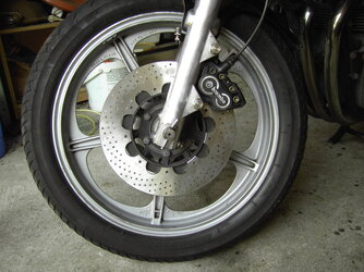

"Calipers don't seem to be a problem although the Laverda type with threads in the caliper appear to be obsolete. So if using one from a bike such as a Ducati, you will need a longer bolt and a nut."
...and some spacers for Ceriani forks if my experience is anything to go by. The upper and lower spacers required aren't the same width either if the one I'm doing is anything to go by.
1200TS
you are ignoring imperial dimensions which do come into affect here,
Ceriani forks on Laverda will require callipers with threads, and Marzochi forks on Laverda, without threads, plain callipers can be fitted with Timecerts, if you are a skilled engineer, to get the thread back, and of course threaded callipers can be drilled out, BMW callipers which look the same as Laverda PO8's, have a different offset, however Brembo four pot callipers from BMW can be used in the same way as Laverda type four pot callipers (if you can stand for or remove the "BMW" Llogo) its a very complicated subject and it would seem that Brembo are slowly stopping parts only supplies due to public liability issues, Ducatipaddy here in UK has good stocks of Brembo parts and replica parts, he is also very knowledagable. I bought a Chinese made rear master from him recently and have not looked back.
What is being missed here (again!) is that the un-threaded P08 calipers usually do not have the mounting lugs machined on the (incorrect) mounting face when fitted to forks calling for threaded lugs. This results in wonky mounting of the calipers, perhaps not too critical in use, but often looks simply terrible from an engineering POV, especially with a nut fitted to the inside of the caliper.
On these later calipers when fitted to a corresponding fork, mounting bolts bear on an un-machined, as-cast surface that is rarely square to the rear machined surface of the lug. The lugs need a slight skim on the mill to get them flat and parallel and spacers to get the calipers centralised over the disc. Only then can the calipers be rigidly mounted without any stress being introduced by mounting bolts into either caliper or fork lugs.
There is no shortage of the later un-threaded type, still available new from Brembo outlets. The threaded type, in all variations, has become extremely rare, especially in usable condition.
A cheap and easy upgrade on Ceriani forks is the use of 4-pot Brembos from K- and R-models from BMW. These have identical mounts to the early P08 but different lateral spacing. This is easily corrected with a couple of spacers.
