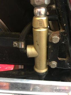

Anyone out there recognise my RGS rear master cylinder? Not convinced it is original.
Need to find an overhaul kit, seems to be doing nothing at all...
Just the "Oro" version of the cooking one in black...
You should find another stamping denoting the size, 2 sizes were used, 12 and 14mm iIrc. Each had their dedicated outer lever to compensate the different ratio.
