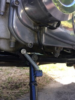

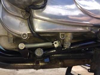

Chris's RGS
On the above photos you'll notice I welded a lug onto the side stand to accept the spring. It should be noted that its position is just in front of the primary chain adjuster so it doesn't hit it. For the second mounting for the spring I welded an L shaped bracket onto the frame.
The second mounting can also take the form of a plate held in position by the pivot screw holding the stand in position as done by Steve (breganzane), this also works well and doesn't require welding to the frame. I think Steve's photo appears in another thread somewhere.
The stand works well and doesn't require any feats of balance trying to hold the stand down and support the bike at the same time,
