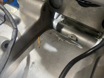

Everything was going just swimmingly, engine nearly ready to lift out when Red wanders over, has a look and goes, fuck, that's not good, and points out a neat crescent shape crack in the case
Had been hiding under the breather, never saw it and never heard it happen.
So that was definitely a hiccup in the plan, only thing I could think of was I was heading home without an engine and now Red had a shit load more work, basically a simple gearbox swap had turned into a full strip and rebuild.

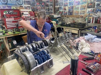

Anyhow, pretty soon the engine was out and up on the bench, already Red had sent Ollie a message asking if he could weld up the case in the morning?

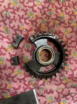

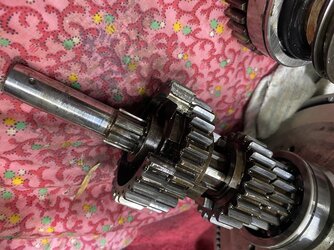

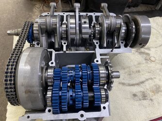

Once the cases were apart it was apparent that the 4th gear had shat itself, not uncommon, Nick G did one last year pulling out of a servo.
One of the broken pieces had then wedged itself up and over the lay shaft , splitting the case, and all at about 7000 RPM
Amazing I never heard a thing...

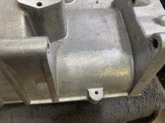

The split case was heated up and the raised section hit back into place, Red then chased out the cracks ready for welding.
Red and I dropped the case over to Ollie, who is about two blocks away, in another slice of Camira paradise, large block facing North, with another absolute killer shed out the back.
Awesome guy Ollie, by 11am he dropped the case back to Reds on his way out with his misses.
Repair was perfect!
He had to chase out further cracks that became apparent when heat was applied, but the end result

More cleaning of cases and then the engine was ready to be put back together.
Billet 4th gear replacing the original.

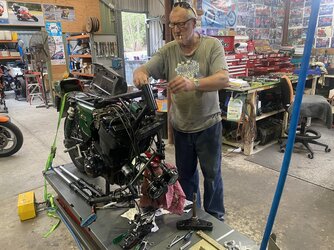

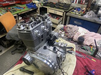

Anyhow... by 4.30 the motor was back in the bike and Paul and I set about hooking everything up.
520 chain conversion took a bit of work.

So next morning, early start as usual and by 11 we are ready for a ride.
