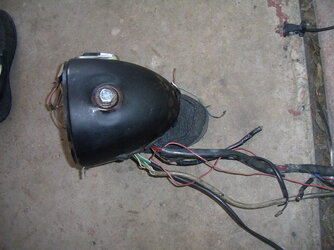

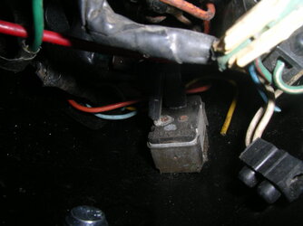

& then I want to do something about the wiring on 8787. I was told before that the Lucus switch is for the lights. ? (pic 4) I have the schematic in Green Bk. Will send more pics...I will have a lot questions.
