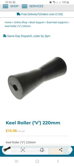

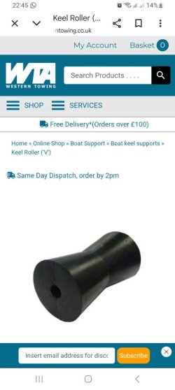

I tried looking at marine shops for boat trailer rollers. They have several typed but not these. Could be wrong but don't think these are trailer rollers.
Reckon you're going to have to try harder Dave. Keel rollers come in differing widths , these look the same.

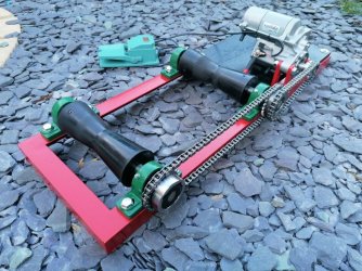

Rob – I think that’s the roller I have. I bought it on Amazon. I can’t figure out a way to inexpensively mount it to a shaft. Dave
That looks almost identical to my starter. I know it was offered as a kit as well partially built. I will see if I can find any info. BTW, the rear roller wears out pretty quick, and smokes like a good un.
Andy – you’re correct, the photo is from an advertisement for a partial kit you can buy on eBay. The kit includes everything except the frame and motor. Dave

Here's the link to the eBay kit. If you look at one of the other pictures you can see that the rollers have holes drilled diametrically through them. The obvious inference is that there's a matching hole in the shaft, and a pin pressed into it that locks each roller to its shaft. I suspect it's a solid pin or possibly a bolt rather than a roll pin. I'm not sure that a roll pin would be strong enough to take the torque without collapsing.
I just read the text in the eBay ad. It says the rollers are glued and pinned to their shafts.
