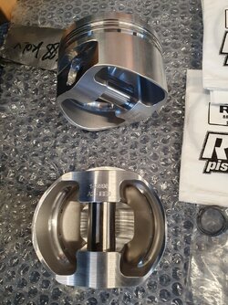

They are for a twin.
You need to change the sleeves, I bought my LA-sleeves through Wolfgang. Then a workshop helped me with machining the barrels and upper crankcase to fit the bigger sleeves.
The reason I am selling them is I wanted to be more on the safe side and went for 88 mm pistons from Red.
After that I have heard that 88 mm pistons has been used in a number of engines without problems.
Lately I was talking to a friend who has built a twin with specially made 89 mm pistons. He has had no problems with oil leaks or reliability.....
As I went for 87 mm pistons I could buy gaskets from Andy Wagner. The sleeve holes in the base gasket was a tiny bit too small for my sleeves but it was easy to grind off without destroying the gasket.
I have seen that Moto Officina offers 900 cc conversions so they can probably sell head gaskets.
My friend who went for 89 mm made head gasket out of copper.
