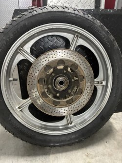

I have both wheels out of the Jota at the momnttook the opportunity to replace the box section swing arm that was on it, really ugly thing !
Just had new BT 46 tires fitted, so before i put the front wheel back in i would like some feedback re the stock rotors and calipers vs the 4 pot Brembo and floating rotors.
I have a set of used calipers/ adaptors and rotors and am condsidering fitting them , they came with the bike, years ago.
My questions , are they a direct replacement to original rotors ?, my originals are looking a bit worn, not measured them but will to check minimum thickness. Original are heavy !
I am not interested in doing the fork reversal, so if its a straight forward swap out, leaving the forks as they are,,, can i retain original master cyinder ?,
Are there any draw backs, and advantages? im an average rider at best, so not looking to outbreak anyone or stand this thing on its nose, but the last time i rode the bike i rememember the front brakes being pretty lacking in ,feel,but they stopped me !
Appreciate any thoughts / Advice
Thanks

4 pot Brembos, floating rotors, and an upgraded m/c would be a superior upgrade over the stock configuration, but the question is if those rotors will fit onto the wheel hub and align to the 4 pot calipers. EBC has rotors that supposedly will fit, and I believe reversing the wheel will prevent the speedo from working. If those rotors are larger diameter you may have to fashion a mount for the calipers to fit. The m/c has to be compatible w/ the calipers, and the brake pads need to be compatible to the iron or stainless rotors. My Aprilia Tuono w/ identical 4 pot Brembos has awesome brakes, and you can buy a new or used Brembo m/c on these Aprilia Forums:

Well thanks for the info, I have read up a lot of the previous posts, doiing the install was my main question and Ive ansewered a lot of my own questions this morning.
The rotors fit the Jota rim ok
The calipers have the adaptors as in the picture and fit the fork mounting points, hower the Rotors do not have enough offset to line up with the calipers when installed.
So either i have wrong rotors or a spacer required to mount to wheel, either way i will leave as stock, finish putting the bike back together give it a runs see how the brakes feel and talk with Wolfgang re seal kits / pads etc
