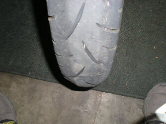

Good question I don't know how many ks are on the Bridgestone T32 front. I started logging this 16 months ago as I never knew and keep seeing people say X with certainty. I just went back on my calendars and noted I fitted a rear T32 Bridgestone on 10/10/21 and it's very close to done and has 9197ks in 16 months on it so I am bloody happy with that kind of ks. They may not have Super Sports grip but I have no complaints wet or dry. So I will keep logging this on the 3c and Atlas. I really doubt that front has done the same or more but I cannot remember when it went on but unless you write it down it's not an experiment its a guess, I wish I could be certain but 9000ks out of a front tyre, Naa really Naa.DSCN0485.JPG
That's the front size in that pic, the rear is the 140 but I have a 3.00 rear rim. Not exactly the correct rear rim but the tyre fitted comes out at 135mm so it's pinched by 2.5mm each side or 3/5ths of fuck all. That 140 fits and clears the chain guard but that guard needs to be moved to the outer side of the mount at the front plus you need to trim a bit of the front of the chain guard so it clears the frame rail on big suspension movements. Make absolutely sure you can get that 140 if you're going that way because sometimes it's listed but not imported from Japan, it fits early GXSR Suzukis and not much else.

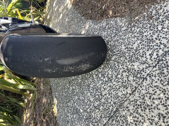

The 150 Dunlop on the Motodd measures 160mm hence why I'm going down to 520 chain.
That last little bit on big modern rubber disappears really quickly, like reasonable at lunchtime and canvas showing 30 minutes later.
