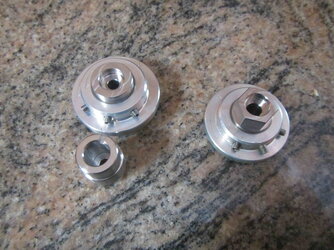

has nothing to do with the fit of the rotor, more to do with making the job easy
when rotor is in position on the crank adapter so magnets are aligned then you have something like 4mm of rotor to grasp to turn the rotor into position which makes the job a bit delicate
by drilling a pair of holes in the face of the rotor and it does not really matter where you drill the dam holes it makes the job easier
on the Redax system we added a hub to the rotor which makes it far easier to position the rotor into the correct spot timing wise and it also means if the person doing the installation does not apply the recommended dab of Loctite to the grub screws as written in the instructions then when the grub screws do back out they will not destroy the triggers as they are no longer inline as is the case with the Sachse system
An excellent mod Red, making life easier (especially when the assembly needs to be removed) and more idiot proof :cool:
