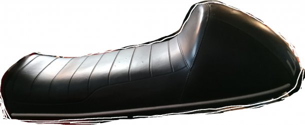

unfortunately what I have is a DIY (not me) saddle and it is completely different from the original one.
Completely means both shape and material (at least). In order to understand, herewith enclosed two pictures, one is mine, the other is the expectation. I leave you the choice about which is what.
