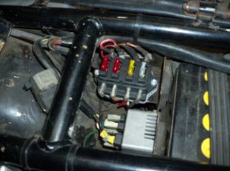

the original fuses gave me trouble, sometimes, the lights would be on when idling but off when moving.
a wiggle of the fuses would get them working again,
I checked all the wiring, cleaned as many connections as I could and replaced the fuse box with blade type, and no issues since,

skinny pinney has a very good point, the torpedo type fuses that are sold now are very poor quality, and they very often do not have the pin point connection that is required and one end of the fuse for installation in the standard Bosch fuse box, one end is as I say an indent in cast brass to locate the very tip of the fuse, the other is held under a brass sheet metal tang, which looks inferior, but usually the problem is the other end, never mind if this is the problem or not, always a good idea to change to a blade type fuse holder, see pic of TOG.
