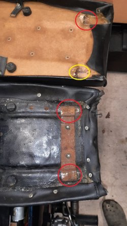

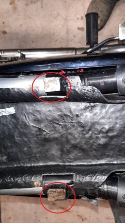

So in the first attached picture is the tabs on the frame at front of seat, where the 'slots' on the seat slide under/over.
On the second picture, the lower seat is the single-humped seat which came with the bike. It shows that a previous owner has fabricated and attached a metal bar which has a couple of raises at the ends which allow the tabs on the frame to go between the seat and metal bar. Industrial, but it works okay.
The upper seat, yellow circles, is a double I have just received. It fits the frame okay, but there's nothing to fit over the frame tabs. The base is fibre glass, and there are two slots in the glass which look as if once upon a time they either fitted over the frame tabs or they housed something which fitted over the frame tabs.

Fibreglass seat is the standard setup.
Is the other seat a metal base or black painted fibreglass?
Whatever, as Cyriel points out, the frame tabs are too short. Easy to remedy.
Ah, thanks guys, that explains things. Both bases are fibreglass, the single one is black painted.
Doesn't look like the tabs have been replaced, but they do look as if they may have been cut short at sometime in the last 50 years. Hey ho.
When you say easy to remedy Paul, do you mean having new tabs welded on, or extending the existing ones?

SeanView attachment 102730
I'm no welder either, but yes, either replace the lot or weld a new tang on.
You can actually get away with no front tabs as long as your rear bracket is securely bolted. if you want to return it to original you'll have to fabricate brackets as per Cyriel's pic. The hump seat fibreglass base will then need to be modified to replicate the original double seat slots.
The tabs on my SF are longer but also a little pointed at the end to aid location. The wee holes in the fibre glass are still ratty tho. All a bit of a balls ache compared to a hinged seat
Yes, those fibre glass seat bases eventually get damaged where the prongs locate. I cured that by using plumbers plastic tube wedged into the saddle to locate the prongs.
