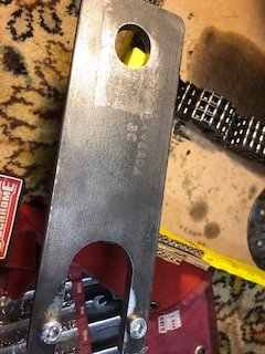

This nut spun off using a very heavy duty Snap on impact gun and deep socket - good tip thanks, I will need the special tool to lock it all up to get the correct torque setting when I rebuild
Fitz,
Here?s a locking tool for you.

The new version of the Green Book have eliminated that recommendation because of the number of breakages.
Either use the factory tool or a home made equivalent if torquing that nut is important to you, otherwise, use a rattle gun, electric or air powered.
Only one torque: bloody tight + Loctite.

The method using a homemade piece of steel could very well damage the teeth on the clutch drum or crank sprocket.
I have used a piece of copper bar on multiple occasions and haven't even scratched a tooth.
Gerald
Neither of my SF2s have any holes in the primary sprocket for such a tool. Anything at all put between the sprockets risks breaking clutch sprocket teeth. Any good rattle gun, air or battery, will do it. Just make sure it is fucking tight. One that I did up with my rattle gun took a long time to remove with the owners one which was not as strong, we thought it might not come but it did in the end.
