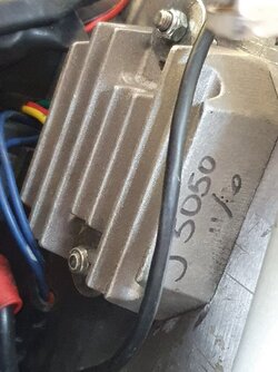

ND alternator from a GPZ/GPX 900/1100 Kawasaki running via a Gates toothed belt running at 1.75x crank speed - two wires to the battery (reg/rec inside the alternator). Lighter than a dynamo, produces power at idle, allows fitment of a much smaller battery. Very tidy fit. Not a small amount of work involved but nothing crazy. PM me if you want pics.

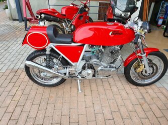

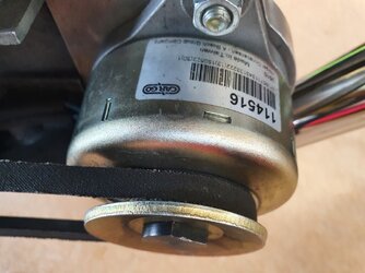

When I have built my special I have used different new parts just like You Fitz. Electronic tacho, LED-lights, Ignitech ignition and a Kubota dynamo. The Kubota dynamo is efficient and has lower weight then the old VW-dynamo. The size of the dynamo pulley makes the gearing almost the same as for the original. The voltmeter on my Motogadget tacho is showing 12,5V at 800 rpm rising to 14,5V at 3000 rpm and staying at about 14,5V at higher revs. I have not measured any Amps but after about 700 km my 10 Ah battery still has the same voltage.

Smaller and tidier than mine, although with the cover on mine looks very compact - ND unit, cranks out loads of power, no reg/rec required.
