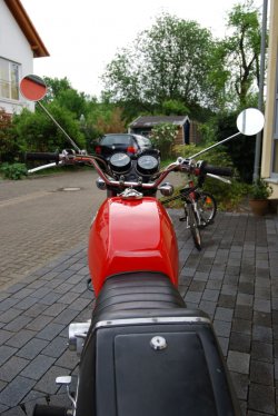

I am afraid I have to put 2 mirrors in my SF3 to pass the technical inspection... any recomendations and where to buy them? I may leave them so would be nice if they have the original look.

Any after market mirrors fitted to the clutch and master cyl perches look fine. I used to use rubber silent blocks from 70s Kawasakis that go into the perch thread and the mirrors thread into those.
Standard SF3 clutch bracket doesn't have the mirror mount. You can buy universal ones in cast or sheet metal or use a bar end mirror for the left.
I have cheap steel ones on a stalk with extenders so as they are wider if you see what I mean. Mounted on the brake bracket on the right and using a metal collar on the left.
