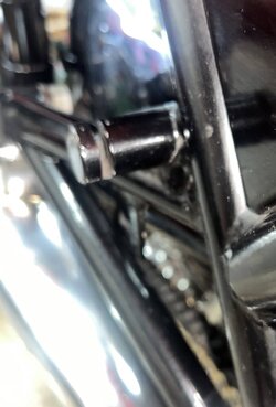

I also need to ask the obvious regarding the SF3 gear crossover position.
Does the crossover shaft pass over the top of the rear case bolts since there is usually exhaust collector box issues underneath a twin.
The linkages all seem to line up.
