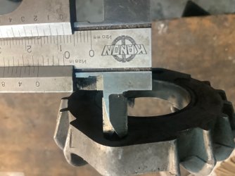

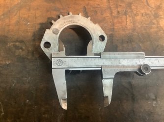

Hi
I've just lowered the exhaust collars from the heads 8mm studs.
The ones fitted to the bike have no grooves for any half rings, flat rear face.
No half rings.
40mm inside diameter and 8mm stud holes.
So this is the spec that I'm wanting.
Triple flat rear face collars should fit.
