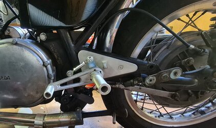

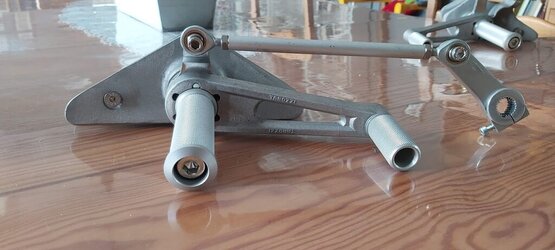

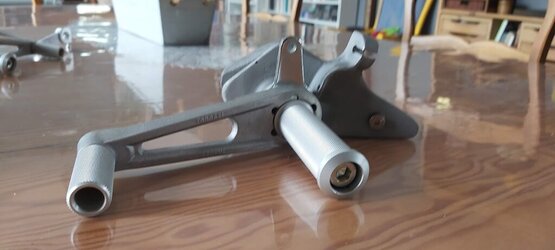

These are my rearsets for a triple with Tarozzi gear.
I made my own alloy plates - not as bling as the two-piece stuff, but worthy of a nice Laverda just the same. You have to be willing to weld threaded lugs into the triangle though.

Fitz - My SF rearsets look similar to Paul's except that the brake (lhs) has a linkage to an adaptor that fits where the exisiting brake lever goes - so it uses the existing cable and brake light switch. Will try to get a pic later. The only issue is that the adaptor seems to have the arm at a different angle, hence the issue with cable length.
One thing to note is that folding Tarozzi rearsets are much harder to fit than the fixed ones. On the fixed rearsets the bolt that runs through the middle is just a long socket bolt and if it is too short you can just change it, on the folding rearsets it is actually part of the unit and cannot be changed. I had to get some long sleeve bolts and modify them to fit.
But the folding ones are so handy, makes walking the bike around easy. Plus extra lean angles are possible with lifting your foot up. Plus small falls don't break the peg with loss of then gear changing the result, you might still ride it home. I really like mine
