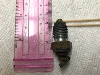

If Laverda switches aren't available, perhaps there's something else that'll fit. For example, I recently replaced a switch in my car's gearbox (diff lock light switch - photo below) and it looked just like a neutral switch from a bike. It's been too many years since I pulled a Laverda switch out and I can't remember the specs (thread and detent ball depth), but the picture in the parts book looks like any other detent switch. Laverda would most likely have sourced them from Bosch and I doubt they'd have been a special order. So something from another bike or car might fit.
What's the thread size and depth (sealing face to tip of plunger) for the Laverda switch? You never know your luck, this one might be a close match.
M14 x 1.5
18 mm threaded section length
face to tip 22 mm though this one is still stuck and worn
VERY similar (read "identical" though others deny this) to those used in the Zane' bikes so a suitable substitute would make both communities happy.
Did you by chance measure your Mitsu part before installation?

Blimey, that looks almost identical to my Mitsubishi diff lock switch. The old one I pulled out might still in the workshop rubbish bin. I'll see if I can dig it out and measure it.
Edit ... some hours later:
I found it. Had a bit of a clean-up in the shed while I was at it.
It's the same thread M14 x 1.5, but this one is a wee bit shorter. It's 18mm from shoulder to tip, so it's not long enough for a Laverda neutral switch. If it had been longer it could probably be used by stacking shim washers under the head.
Maybe someone who works on car transmissions can come up with a longer one. Perhaps a reversing light switch. They've gotta be out there somewhere.
