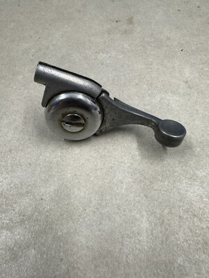

Wrong-handed - not off a handlebar mount Laverda.![]()
Laverda 750 1000 3C moto guzzi 700 750 choke lever | eBay UK
Good condition, 750's and early 3C I think.www.ebay.co.uk
Makes no difference Quentin, just becomes push instead of pull.........Wrong-handed - not off a handlebar mount Laverda.

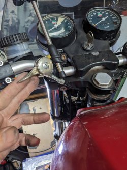

(Broke mine on the Jota and replacement I got was like this - never give it a second thought)
Look closely Quentin, the lever and body can be flipped over for use on the opposite side. Same as the later Laverda type with the plastic lever. Genial design!Wrong-handed - not off a handlebar mount Laverda.
Very genial!! Some smart cookie in the dipartimento del disegno!Look closely Quentin, the lever and body can be flipped over for use on the opposite side. Same as the later Laverda type with the plastic lever. Genial design!
The lever in the pic has left or right cable/nipple attachment - doesn't need to flip. only the body flips - pretty clever. Don't think my SF1 type would do that.If the lever is flipped won't it point down?
