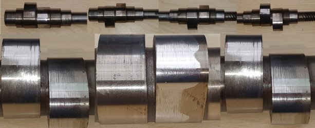

I was setting about getting parts ready for rebuilding the motor of the SF, I have new camshaft bearings, easy enough to replace while it's apart so why not
I am not happy about the discolouration of the cams. They have a peculiar wear pattern but there are no burrs and the surfaces look quite good apart from what looks like a chrome surface treatment that has worn though. There is no ridge or edge to the wear marks, I can also see evidence of discolouring but that may be when they were manufactured and heat treated
Everything else I have found ties up with the engine and chassis number identifying the bike as a 1971 SF model, I am assuming these are standard cams as I can't find any marks on them
Any comments please or recommendations for refurbishing them (NW UK)

The cams look fine to me. I always polish them up on my cloth metal polishing wheels to make them as smooth and slippery as possible and do the same on the rocker arm surfaces. Slipper rocker arms are very dependent on good oil supply, make sure there is nothing impeding it.
If they look slightly scored, I also smooth my cam lobes and rocker surfaces with very fine emery paper then polish as per Tippie's suggestion. I doubt that would be hardchrome plating on that cam lobe - the rockers are hardchromed and you would NEVER  run both together. Making sure they get as much oil as poss is the key to a long and healthy valve train life.
Interesting there are no markings on the cams - my SF1 was the same, even tho every year model has its own numbered cam profile but I would have thought yours was 4S (could easily be wrong).
Stamping 750 cams commenced somewhere around 1973 I would guess. Everything before that was unstamped.
