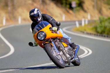

I always cut my own screens, since the pre-cut ones usually have too small a radius, causing the screen to be too high and often there’s an ugly step from the fairing nose to screen. When you purchase an uncut ‘quarter bubble’, you can choose yourself from which section to cut the screen. Here’s one on my 1973 SFC.
Marnix

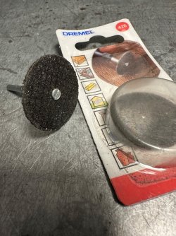

Get a full-face shield and ear muffs like you would use with a chainsaw. Ear and eye protection. Works great for any type of machining.
I have had the centre detach using Dremels. BTW anyone ever found bigger discs than 30mm dia. I usually buy them by the canister. They dont last long. I keep seeing people in those Car Reno shows on TV using 100mm dia and bigger cutoff discs without any guards. I know guards interfere in some cases, but these types of tools look bloody deadly.
Hi Marnix
I see a lot of photos of SFCs with the screen to high. I intend to use my original as a pattern to cut the shape.
I’d certainly do that! Apart from having the wrong arc, pre-cut screens (photo) usually tidily follow the line of the upper wings, which the originals never did.
Marnix
