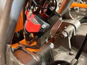

And finally ,the front battery tray holder supports bracket can’t find anything about that!

.. and here’s the battery tray bracket, on the ex Larry Strung SFC that has no battery tray but now acts as a mounting point for the coils, so it is easier to show.
Marnix
