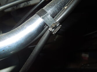

The generic cable ties as we know them today were in their infancy in the early 70's, I'd guess Breganze used something special, like these;DSCN0785.JPG
OE fitment on my '74 Chott. Used for attaching the wiring loom to the frame as well. I've found them on other survivors too.
Please excuse the dust, bikes will be thoroughly cleaned and polished before taking to the road once weather clears. ;)

Thre are a couple of these on mine.
If you are careful, you can push the pin (it's not a rivet!) back out, and re-use them. A bit fiddly to re-fit but eminently possible.
