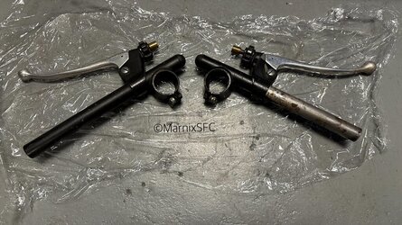

This is an original set of clip-ons and levers, not for sale. All were Verlicchi items.
They were made to take as little room on the handlebars as possible and to enable them to be mounted close to the fork stanchion. Extremely hard to find items.
The clutch lever was also used on some Ducati roundcase Sports and Supersports (good luck with that😉).
Best you can do is transforming GT/S/SF items, which requires cutting and welding, but it can be done.

Thanks Marnix, now I know for sure I will source some GT/S/SF items to adapt.
