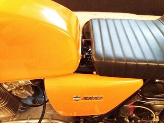

A few years back I was trying out a SFC style seat on the 3CL using an alloy plate with hinges and locking bolt.
I believe the seat may have originated from A. Wagner, came second hand to me.
Didn't really like the look with a gap between seat and OEM tank, dimension are OK otherwise.
