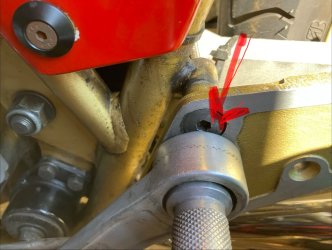

Hi all,
Undoing the foot rest mounting plates,
These bolts are well and truly stuck.
Before I go to town and do some damage,
Is there any reason to think that this is anything other than std thread, not left hand ? See attached image.
Using an impact wrench, I tried plusgas type spray dismantles and dripped a mix of acetone and oil,
Thanks in advance,
Stuart
It is standard thread, I think M 10. The issue is that these countersank screws just use smaller Inbus keys, 6mm in that case and the screw can easily damaged by high force.
The fact that they're countersunk make them so stubborn, just so much surface area that offers cohesion. A little corrosion makes it even worse. The small hex for the socket doesn't help matters at all, that is quickly rounded when applying the required torque.
Hit the bolt with a centre punch at an angle on the top surface in the loosening direction, normal RH thread. A couple of wallops with a hammer on the socket may help to break the initial grip, but that often ruins the socket, unless you have a copper or lead hammer. Maybe you'll find an old, rusty socket that you can sacrifice in grandpas old tool box...
You'll probably need a new bolt no matter how you manage to remove it.
A 6mm hex doesn't offer enough leverage, not even for a rattle gun. It would just round out the hex. An old-fashioned impact driver (the type that requires a hammer) could do the trick though.
At work we often used M8 countersunk screws with an 5 mm socket. When our tecnicans had problems to get the screws out, they used a Torx socket and hammered the socket in the screw and could dismount it. Or us a drill to get it out.
I had exactly the same issue with an sfc 1000 that I owned. Ended up drilling in to the centre of the bolt and progressively increasing the drill size. Ended up with the countersunk head drilled off and then just unscrewed the remainder by hand. Piet is correct in saying that it’s the countersunk head that’s the problem. Upon assembly I used anti siege on the countersink and had no issues later on. Good luck👍😎

Agree w/ the punch but I've found a brass drift works as well & the soft brass won't damage the fastener. My 2p worth-
Yep, got the old classic Japanese impact set in the nice blue metal box when i got the DT2 Yammy. Not a choice ... obligatory. Still got it and it comes in handy now and then. It's a clever system - impact to shock the mongrel and a bit of a simultaneous twist in the right direction. Far smarter is to ditch Philips heads and go 'modern' alternatives like cap screws!
The torx bit tip is gold, used it a couple of times now. My old boss had a set of reverse drill bits that were useful, if you had to drill a head off, often the drill would grab and unwind the problem screw. Especially if you’d already smacked it with a hammer a few times to unfreeze it
Yeah, I wouldn't mind a set of those reverse drill bits. Generally a fookt bolt head means once the head's off the thread is actually free. Busted studs and bolts with seized threads is another story. If I can, I like to fit the part onto the lathe bed and use a mill to get a flat surface, then a centre drill as cose as dead centre as poss, then increase drill bit sizes until the thread looks like a helicoil. It's very satisfying when you succeed.
I remember to having had the same issues, soacking it with WD40 and other stuff, heat and cooling applied and at some point, it gave up. Took a while though...
If you can get the lower one out you may be able to rotate the whole plate anti clockwise enough to get it to move...

I use a mix of acetone and ATF red automatic gearbox oil. Continue to lube it and let it soak. Give it a punch every time. That is the gentle method. Other than that: do what the others said.
Note: the SFC1000 footrest consoles are not that robust, so take care in any case. I've seen one getting a hairline split.
