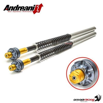

Fork: I have sent the forks to HH-Racing in Germany. Took a while, but they are really, really transformed now! There is an Andreani cartridge conversion existing at least for other M1R types (Guzzi Daytona, BMW), which make a lot of sense. However, you would need to check if the stanchions have the same thread at the top as the BMW f.e. and if the cartridge is long enough. If so - they provide more than you can ever squeeze out of them...

Nick, the rebound adjuster’s can be made to work apparently by using different stre spring’s but they are no longer available from marzochi. The best thing you can do is have them converte to cartridg’s. Cartridges are available from Matris and Andreoni I believe but I have had two set’s of M1r’s converted by a local suspension guy. The first was done using Suzuki gsxr cartridges on an sfc1000 and was a revelation compared to what it was like before. The second set I had done are on my Jota and they use Honda fire blade cartridges and that bike once set up doesn’t get changed. The cartridges are all lying around at suspension shop’s not being used because owners have updated to better unit’s for there jap weapon’s . I tried gold valve’s but was not impressed on either the sfc or the Jota🙁. So you have choices, just depend’s on how comfortable you want your bike to be in term’s of ride quality and handling😀👍 and how much you want to spend , but both mine were under a grand each and worth every cent.

As the emulator mostly helps on adjusting compression damping, it can only help on one of the two sides of the fork. I haven't tried them on a M1R but I think, if you go for a modification, why not going down the full path and simply modify the fork with cartridges?
