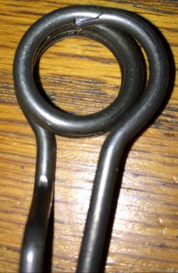

The big one is usually the problem.
I've got through half a dozen or so, in forty-four years on my 180? Triple, and now consider it a service item.

All the ones that I've had fail have done it like the one pictured. It's possible to limp home with it broken but carrying a spare and fitting it is a damn sight easier, and safer.
