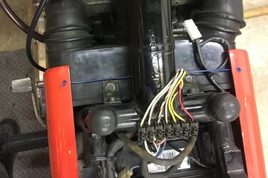

This is how I fixed the problem, forty plus years ago.
Does require a 4mm hole in each side panel, out of sight unless the tank is removed.
Strung with strimmer cord.
Good idea - I'd imagine that this would also work with a kind of hook and a (not to weak) spring - with this both panels could be taken off more easily ...

Both can be unclipped and slid forward, out of the way, for battery removal, etc.
This has the additional benefit of them not being on the ground, where they can be stepped on, cracking them.
Don't ask me how I know that?
Thanks Hamish,
so the panels can be slid forward - but I'd prefer a solution which would also allow to kind of unhook them. I think I'll copy your idea, but would try to integrate this additional function ...
