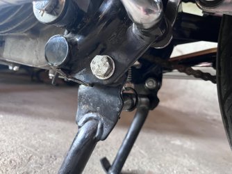

I dont have that kind of frame as it is on your photo. Now it is a central stand on and I dont have the possibility to instal also the side stand. Can they be both mounted at the same time or only one typ of stand at once.
KR, Mitja
All SFs came with both a centre stand and a side stand. The bracket for the side stand may have been cut off on your bike to fit an SFC 2/1 (which also requires a different angle on the left leg of the centre stand). Can you post a pic of your stand and the left side under the lower engine mount?
Here are the pictures.

Mitja,
In the 4th Picture you can See, that the Mountingpoint for the Sidestand
is cut off.
8mm Steel and a Welder should fix this.
Compare my Pictures with your Frame and you See the Difference
Rainer
It's shame it's been chopped off - I can't think of any reason to do that because it doesn't interfere with anything and the centre stand is still stock standard. At least you have a nice heavy steel frame that is easy to weld.
