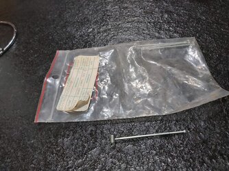

As mentioned concerning getting needle jets out, I'm renovating the carb bank on my 3C.
I remembered that I had some rods in my pile of bits, ostensibly for lifting the slides in a triple in lieu of the cables in there at the moment.
It's NOS Laverda parts bought when a local dealer sold me his stock a long time ago.
What were these fitted to?
Is there any advantage in using them over the cables? More synch stability maybe?

AfaIk, these were fitted to RGS onwards. More reliable than the previous cables. Failure of the cables is very rare, but it does happen, usually in the middle of Austria, ie, a long way from home, on a Sunday afternoon.
I'd prefer them over cables any time. Need some extra care when fitting, the rod bends easily if the drum nipple isn't properly located in the crank arm.

Thank you Piet.
Rods it'll be.
Had them in my RGS. The disadvantage of the rods is that with the tiny ball at the lower end tends to work it’s way through the slide. A cable with the traditional nipple has more contact area, so doesn’t have that problem.

Of course, your cables / rods and right wrist will all benefit from reducing the slide-closing spring forces.
