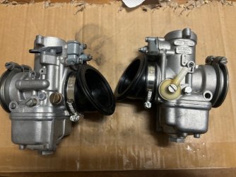

I soda blasted a pair of Ducati carburettors the other day. They were stripped down to the bare aluminium bodies at the time. I forgot to take a "before" photo but they were pretty grubby. It didn't remove all the staining from the alloy, but they came out a lot cleaner than they were. After the soda blast, they went through the ultrasonic cleaner to remove any crap inside and to dissolve out any trapped soda.
I use a specific carb cleaning solution in my ultrasonic tank, and it does clean the carbs up really well, and then soda blasting finished off the job. If you were happy to block all the orifices up, then using a walnut shell media would also work well.
